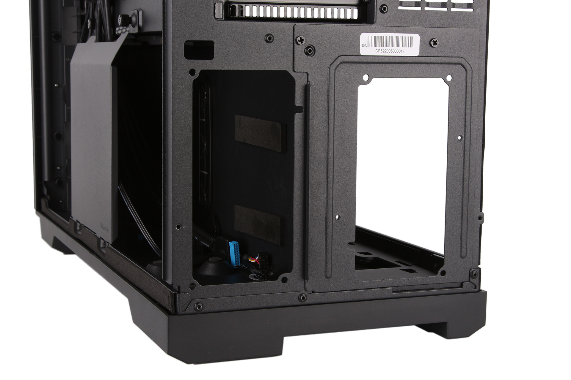

For dual-PSU builds (not common, but maybe suitable for workstations that need extra power or redundancy), a second PSU mount is already present on the rear panel, but by default it’s blanked out by a cover plate. You’ll also be needing a PSU capable of linking with another, making this feature something of an advert for the Seasonic-built Phanteks Revolt Pro PSU, which can do just that.

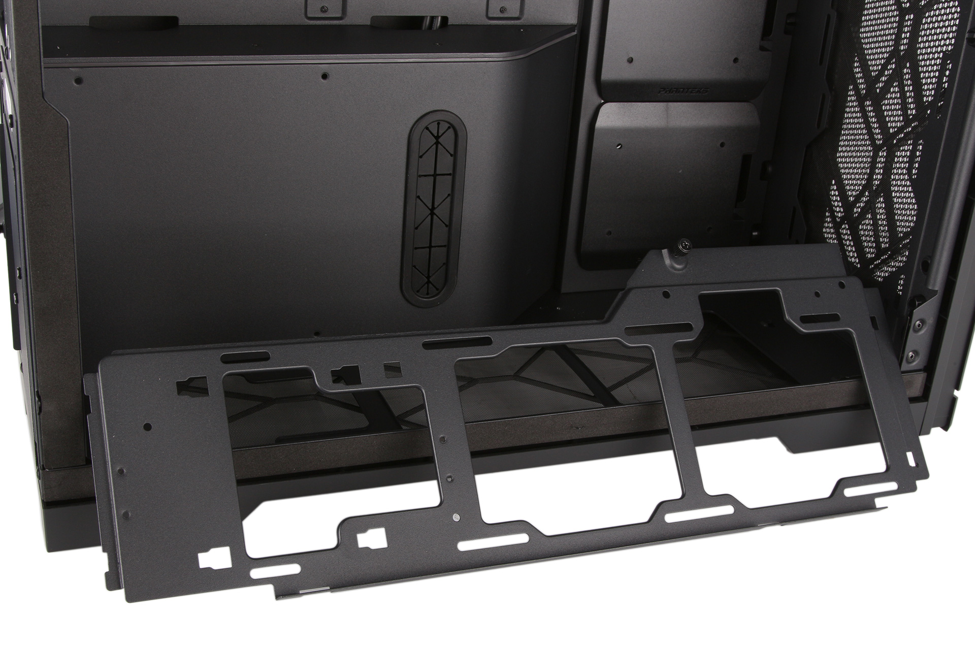

If dual-system is more your thing, the second PSU mounting bracket can be swapped to the bundled mini-ITX motherboard bracket, with the board then being installed on the vertical portion of the PSU shroud. The bracket design permits a vertical GPU to be installed for this second system too, but again you’ll need to grab a riser cable separately. As expected, Phanteks sells this as well as the Revolt X PSU which can power two separate systems.

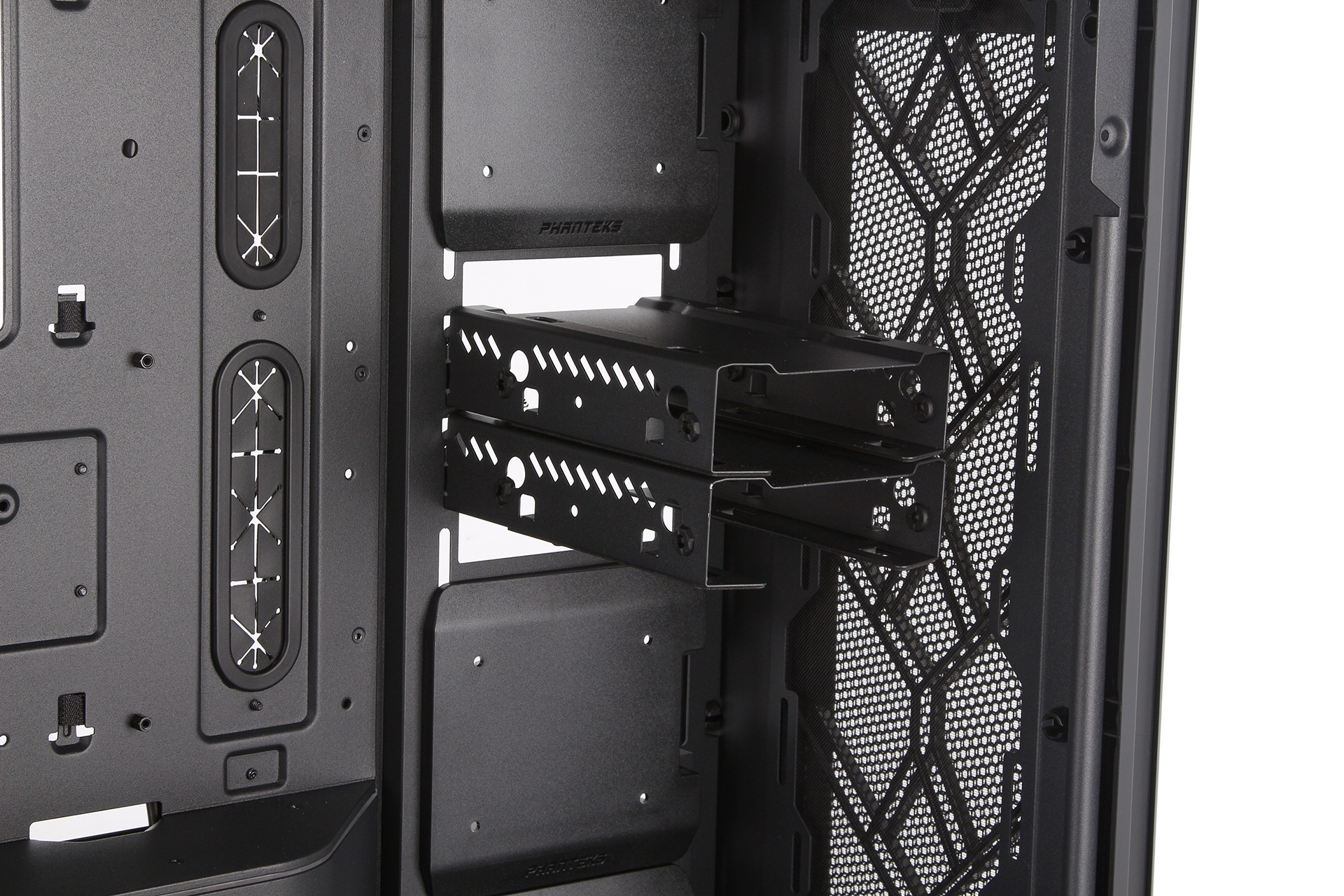

There are four blanking covers stacked vertically at the front, each of which can host a pair of SSDs/2.5” drives – one screwed to the front facing the window and one secured tool-free to the rear. The design is made particularly nifty by the cable routing fins on the back. Alternatively, each plate can be popped out to reveal mounting holes for either a single 120mm side fan/radiator or up to two Phanteks HDD cages (four of which are supplied). It’s a great design that allows you to choose between SSDs, HDDs, fans, and radiators, but the blanking covers are too easy to knock out of position when working with one of the others.

The design of the HDD cages impresses too. They are solid metal with foam tactically placed, and they can be stacked vertically using their rails. The default four-HDD limit will satisfy many, but the front section can of course technically hold up to eight HDDs if you purchase the extra trays. That’s not all, because the ITX motherboard/second PSU area can host another four such bays stacked vertically from the floor, bringing the theoretical maximum HDD support to 12.
